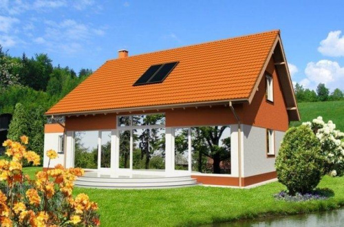

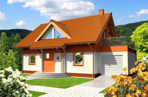

Oto nasz domek:
http://www.fotosik.pl" rel="external nofollow">http://images50.fotosik.pl/194/b0717dd00377945emed.jpeg
href="http://www.fotosik.pl" rel="external nofollow">http://images45.fotosik.pl/195/b844e34bd41e8679med.jpeg
