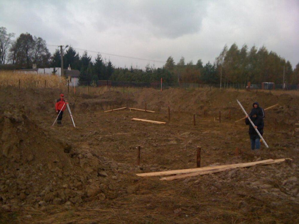

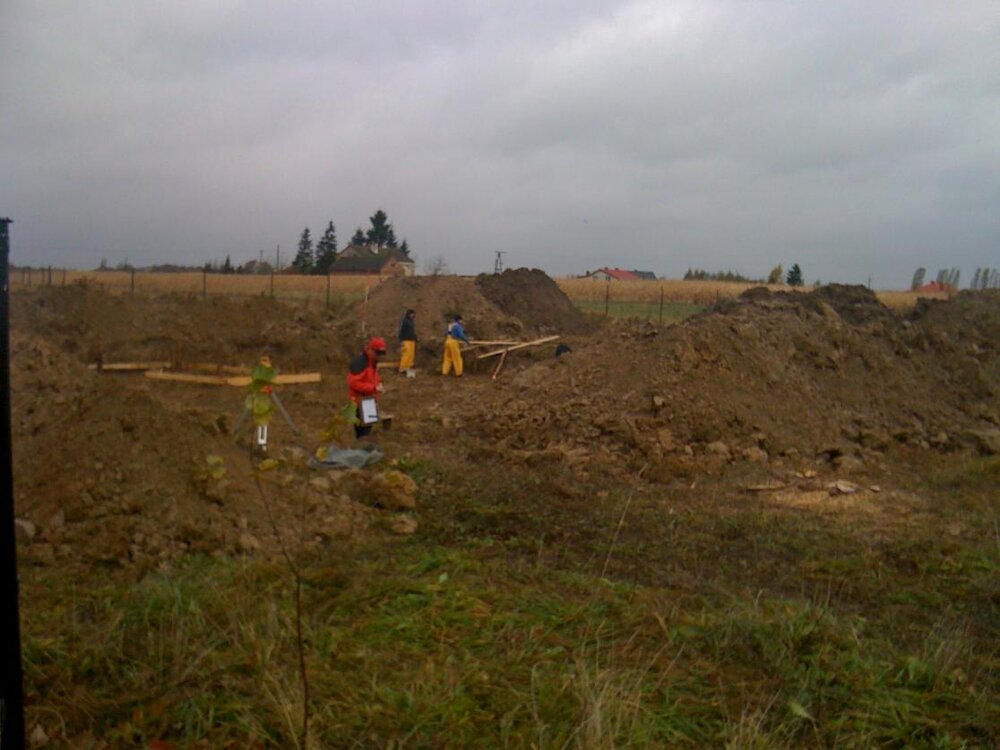

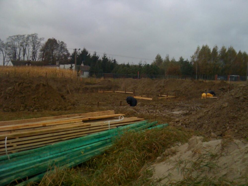

No, prawie zakończenia - chudziaka i kanalizacji nie ma, ale to potem
http://img703.imageshack.us/i/mg0143.jpg/" rel="external nofollow">http://img703.imageshack.us/i/mg0143.jpg/" rel="external nofollow">http://img703.imageshack.us/img703/4647/mg0143.jpg" rel="external nofollow">http://img703.imageshack.us/img703/4647/mg0143.jpg
http://img228.imageshack.us/i/mg0144.jpg/" rel="external nofollow">http://img228.imageshack.us/i/mg0144.jpg/" rel="external nofollow">http://img228.imageshack.us/img228/9831/mg0144.jpg" rel="external nofollow">http://img228.imageshack.us/img228/9831/mg0144.jpg
Ostatnie prace wykończeniowe, betoniarka już załadowana
http://img534.imageshack.us/i/mg0147h.jpg/" rel="external nofollow">http://img534.imageshack.us/i/mg0147h.jpg/" rel="external nofollow">http://img534.imageshack.us/img534/4526/mg0147h.jpg" rel="external nofollow">http://img534.imageshack.us/img534/4526/mg0147h.jpg
