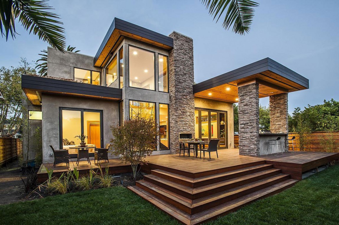

Naszą główną imspiracją był dom Burligame House:
http://cdn.goodshomedesign.com/wp-content/uploads/2013/08/stunning-house-modern-design.jpg" rel="external nofollow">http://cdn.goodshomedesign.com/wp-content/uploads/2013/08/stunning-house-modern-design.jpg
http://mat2.materialicious.com/images/rustic-meets-luxury-burlingame-residence-o.jpg" rel="external nofollow">http://mat2.materialicious.com/images/rustic-meets-luxury-burlingame-residence-o.jpg
