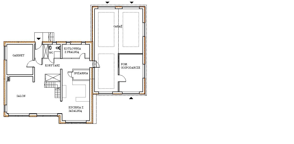

PARTER
http://karolina.reczek.eu/murator/parter.JPG" rel="external nofollow">http://karolina.reczek.eu/murator/parter.JPG

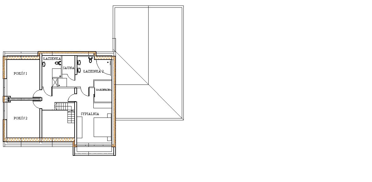

PIĘTRO
http://karolina.reczek.eu/murator/PIETRO.JPG" rel="external nofollow">http://karolina.reczek.eu/murator/PIETRO.JPG

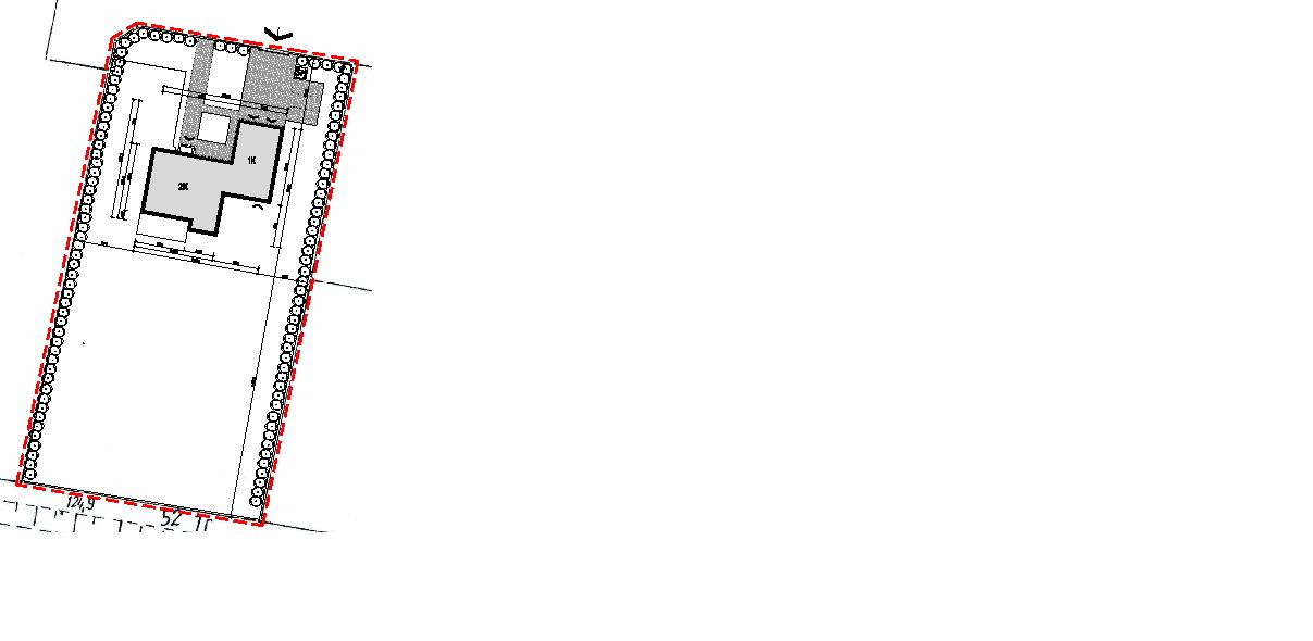

http://karolina.reczek.eu/murator/zaospodarowanie.JPG" rel="external nofollow">http://karolina.reczek.eu/murator/zaospodarowanie.JPG
