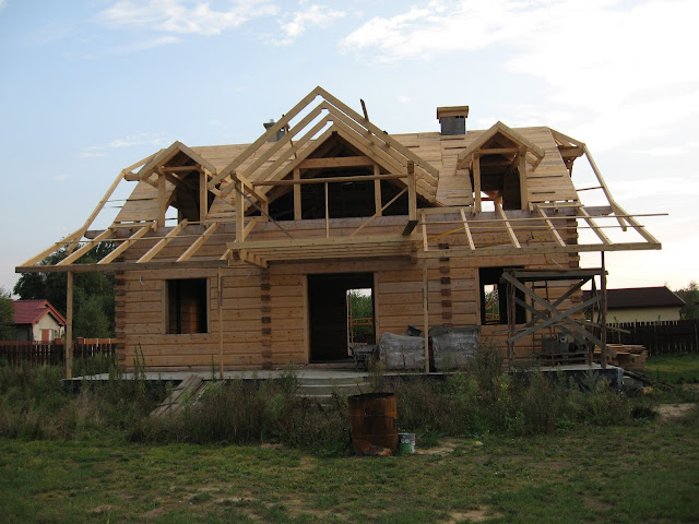

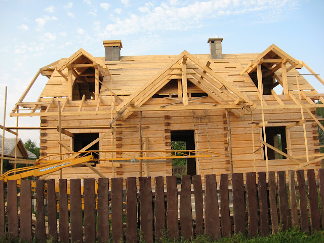

Efekty budowy jak widać:
http://lh6.ggpht.com/_RStl9ovaZ_U/SsNmYHp-1rI/AAAAAAAAAFY/p7PMXhvZ_Wc/s640/Obraz%20032.jpg
http://lh5.ggpht.com/_RStl9ovaZ_U/SsNma_LmNHI/AAAAAAAAAFc/nxmQaYV5hJM/s640/Obraz%20038.jpg
